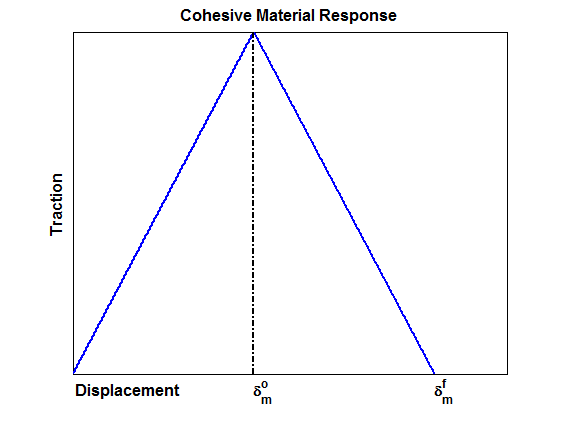

A typical traction displacement curve is shown below. Damage initiates at where D=0, and then damage continues to evolve to the point where D=1 at .
Displacement Based Damage Evolution
For the displacement based damage evolution criterion, user material constant eight is interpreted as the difference between the effective relative displacement at complete failure, , and the effective relative displacement at damage initiation, . Valid values must be greater than zero. The image above shows qualitatively how and relate to the rate of damage evolution.

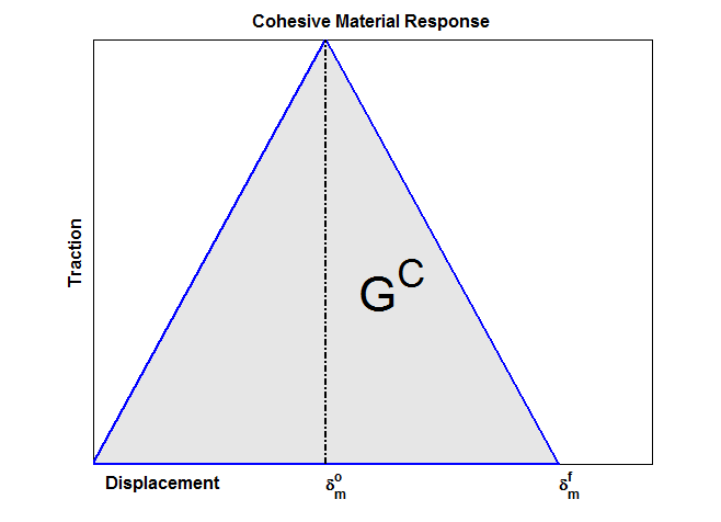

Energy Based Damage Evolution
For the energy based damage evolution criterion, user material constant eight is interpreted as the total fracture energy of the cohesive material, GC. The image below shows how GC relates to the traction-separation response of the cohesive material. The value of GC you supply is used to determine the final relative effective displacement as:
where is the effective traction at damage initiation.
