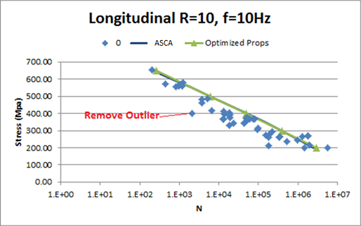

The material S-N data is used to optimize the correct fatigue material constants used by Composite Material Manager. The optimization process involves iterating on the fatigue constants until the calculated error between the predicted fatigue life and the known fatigue life is minimized for both the longitudinal and transverse directions. The error is calculated as
where n is the total number of data points, is the known cycle to failure for data point i, and
is the calculated cycle to failure for data point i.
The method of steepest descent is used to increment the fatigue constants in the direction that minimizes the error described in the equation above. When a local minima is found, the optimized fatigue constants are set and used for the fatigue life prediction of the composite material. If a local minima is found instead of a global minima (which is typical), the optimized fatigue constants may yield an error greater than 1%. Errors larger than 1% are typical for most fatigue data. To ensure the material constants are acceptable, a one element model can be run to reproduce one or more S-N data point(s). Therefore, you should always check to ensure the fatigue constants and their associated converged error are physically sound.
