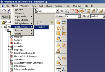

To access the model's keywords in Abaqus/CAE, select Model > Edit Keywords and select the Model Name as shown below.

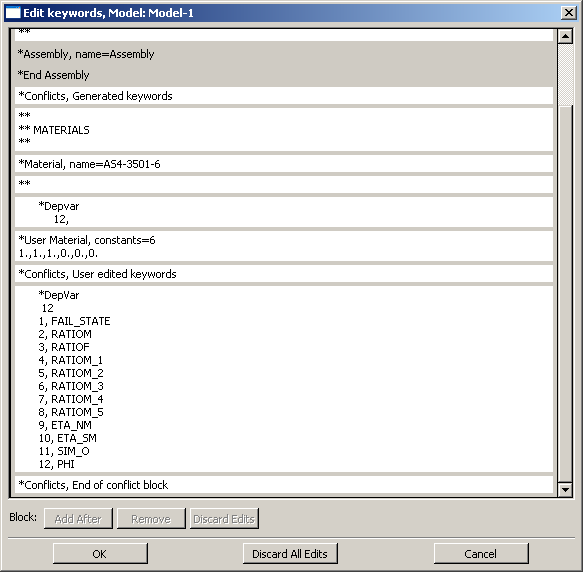

The Keywords Editor is shown below. In the Keywords Editor, note the block of text that begins with "*Conflicts, Generated keywords" and ends with "*Conflicts, End of conflict block". These messages indicate that there is a keyword conflict contained within the block of text. In this case, the conflict is caused by the extra *DEPVAR statement left over from a Helius PFA material that was deleted earlier.
To manually resolve the keyword conflict, delete the extra *DEPVAR statement (including all 12 of its data lines). You must also manually delete both of the *CONFLICTS keyword statements. It should be emphasized that as long as there are user-modified keywords in the model, there is a possibility that new keyword conflicts will be generated as you continue the model creation process in Abaqus/CAE. To completely eliminate the risk of introducing more keyword conflicts, click the Discard All Edits button in the Keywords Editor. This reverts all user-modified keyword statements to the form originally created by Abaqus/CAE. In this case, you should be aware that any of the previous modifications made to the section definitions (Specify Extraneous Stiffness Parameters) will be lost.
