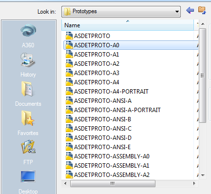

Open drawing prototypes
Opens the folder with the installed prototypes.
To access the command
In the Output tab Document Manager panel, click (Edit prototypes).
Command line: _AstM10EditPrototypes
The Edit default prototypes dialog box (a standard file selection dialog box) appears, displaying the list of prototypes available in ..\ProgramData\Autodesk\AdvanceSteel\201X\Shared\Support\Prototypes.
You can open a prototype and modify it according to the requirements.
