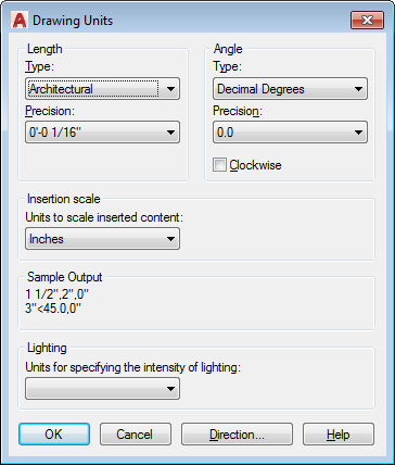

- Set the AutoCAD units: Type _units in the command line and set the units as required in the Drawing Units dialog. It is important to specify the insertion scale to match the unit lengths on the sheet. This ensures that the blocks are correctly scaled:

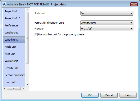

- In the Home tab
Settings panel, click
(Project settings...).
- Set the units as required, in the Project data dialog:
