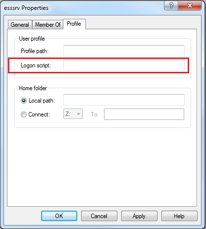

- The best way to manage your shared files is to add a shortcut to the *.bat file in the logon script:
Control Panel -> User Accounts -> Manage User Accounts -> Users and Groups -> Properties - This means that in order to get the updated version of the shared files, users don't need to restart their computers, but they can simply log off and then log back on.

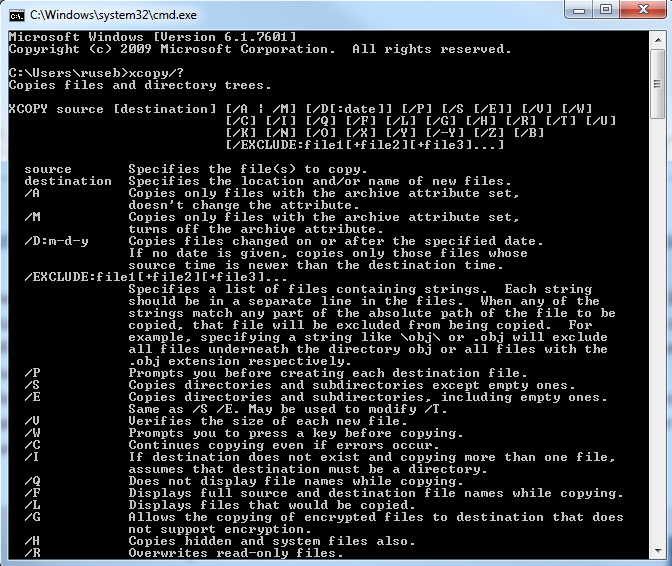

Suggested Switches
/mir: Mirrors a directory tree.
Note:
- For a full list of xcopy switches open the command prompt (type
cmd
in the Run Menu) then
xcopy/?
