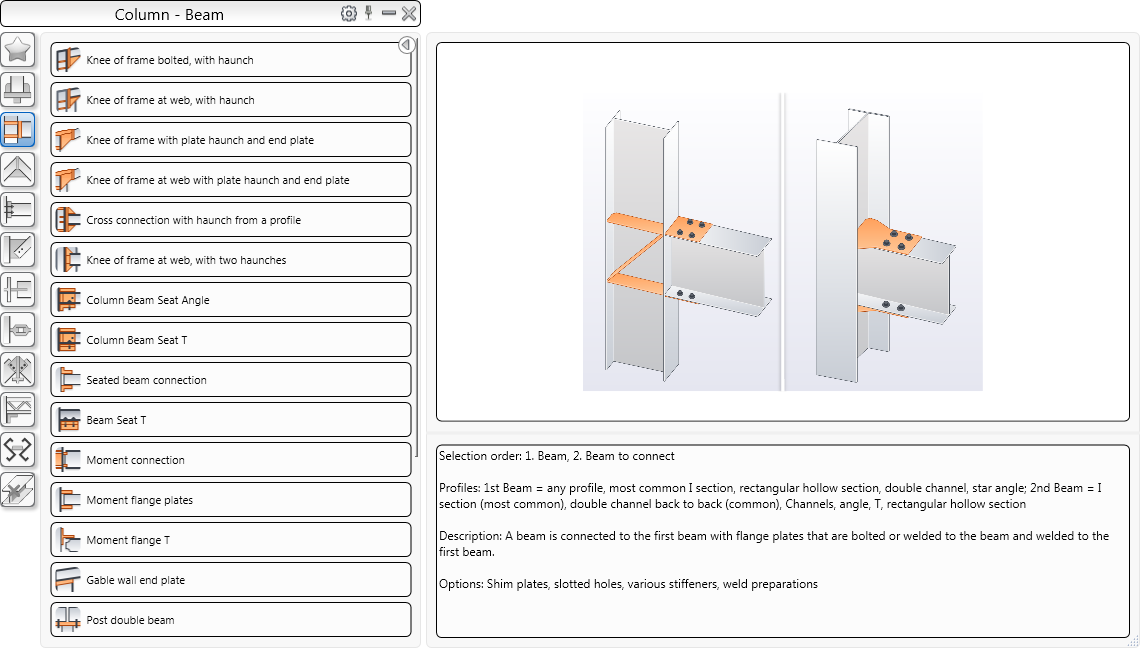

ClickHome tab Extended Modeling panel (Connection Vault). Select from the categories of connections in The Connection Vault. Individual element types display appropriate connections.
Group frequently used connections in the Favorites category for quicker access.
