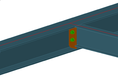

Select the rafter and right click.
Select one of the floor beams and right click to create the connection.

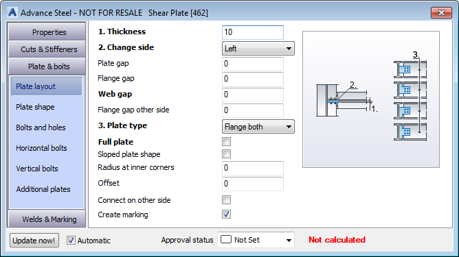

The plate is created and the properties dialog appears. Modify the plate properties to suit specific requirements.
