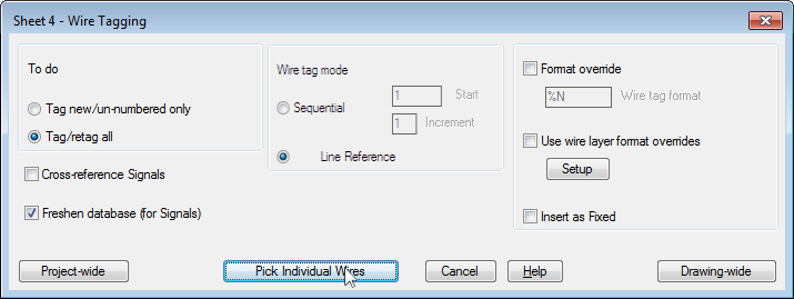

Select the wire segment between the two push buttons on line reference 403 (1), right-click
The wire number is placed.
Add wire numbers to the entire drawing
. Find
Wire numbers are assigned to each segment in your drawing.

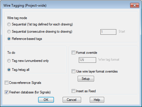

Add wire numbers project-wide
. Find
Wire tag mode: Reference-based tags
To do: Tag/retag all
Freshen database (for Signals)
Wire numbers are processed for the selected drawings.
