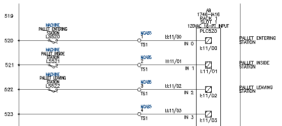

Insert wire numbers based on the I/O address that each PLC connected wire touches.
The wire numbers insert with your specified format as fixed wire numbers. If a wire number retag is run later on, fixed wire numbers do not change.

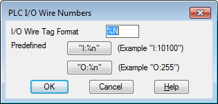

Insert PLC I/O wire numbers
. Find
The PLC I/O Wire Numbers dialog box displays.
The default format is %N, the address number. The wire number is the same as its connected I/O address number.
It adds an ‘I’ prefix to each wire number that ties to the input module.

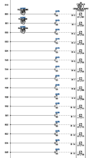

Select I/O module to process: Select anywhere on the PLC module
Select objects: Select all the connected wires to process, right-click
The wire numbers are inserted with the specified format. If some of the I/O points short-circuit to other I/O points, the last point wire number prevails for that common wire network.
