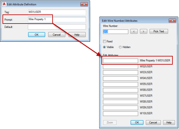

The horizontal and vertical wire number blocks must have a WIRENO attribute. The blocks can also have W01USER-W10USER attributes which can be used to assign various properties to the wire. If you define prompt values for any of the W01USER-W10USER attributes on the wire number block, the prompts are included in the label when you edit the wire number to assign values.
