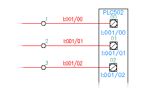

Inserts wire numbers based on connected PLC I/O address values.
Find
Command entry:
AEPLCWIRENO
Wire numbers go in as fixed. If you run a wire number retag later on, fixed wire numbers do not change.
I/O Wire Tag Format: |
Specifies the wire tag format for the plc wire. |
Predefined: |
Uses an exact wire number match on the address. The options are I:%n or O:%n. |
