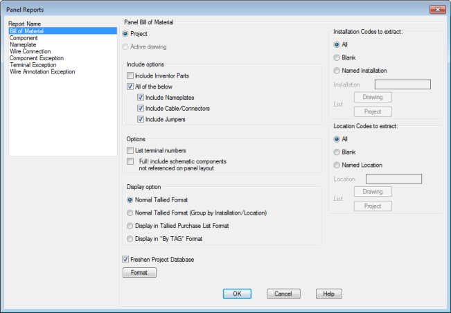

Panel Reports Dialog Box
Generates a report extracting information from panel components, nameplates, and terminals.
Find
Command entry: AEPANELREPORT
List of Options
The following options are displayed.
Note: Options vary based on the report name selected.
Report Name
Specifies which report to run.
Report Scope
Specify whether to process the project, the active drawing, or selected objects. If project is selected, some reports provide an option to select which drawings to process.
Installation Codes to Extract
Filters the information extracted for the report based on installation values.
All
Extracts all components regardless of installation value.
Blank
Extracts only those components that do not have an installation value.
Named Installation
Extracts only those components that have an installation value matching the value entered in the box. Wild-card characters are supported.
  • Drawing. Select one or more installation values from a list of values used on the active drawing.
    Note: If the Bill of Materials option Include Inventor Parts is checked, Drawing is disabled.
  • Project. Select one or more installation values from a list of values used across the project.
Location Codes to Extract
Filters the information extracted for the report based on location values.
All
Extracts all components regardless of location value.
Blank
Extracts only those components that do not have a location value.
Named Location
Extracts only those components that have a location value matching the value entered in the box. Wild-card characters are supported.
  • Drawing. Select one or more location values from a list of values used on the active drawing.
  • Project. Select one or more location values from a list of values used across the project.
Freshen Project Database
Specifies to update the project database with the latest drawing information.
Redisplay Last Run
Displays the previously extracted report.
Format
Opens a dialog box where you can select a format (.set) file. Use a format file to predefine the fields to include, the field order, and more.
Bill of Material Report Only
Include Options
If your project is linked to an Inventor assembly, this check box is enabled. Specifies to include the electrical parts from the linked Inventor assembly in the report. Linked devices that are represented in both an AutoCAD Electrical drawing and the Inventor assembly are not duplicated in the report.
All of the Below
Specifies to include nameplate, cable, connector, and jumper information in the report. Use the individual check boxes to include or exclude any of these.
Options
List Terminal Numbers
Lists each individual terminal in the format strip-ID:terminal number. Otherwise terminals from the same strip are combined into a single entry with a quantity.
Full
Specifies to include all schematic component information not found on any panel layouts in the report.
Display Option
Normal Tallied Format
Combines and tallies components that have the same catalog information. Subassembly items and multiple catalog values are reported as line items directly following the main catalog item.
Normal Tallied Format (Group by Installation/Location)
Combines and tallies components that have the same catalog, installation, and location values. Subassembly items and multiple catalog values are reported as line items directly following the main catalog item.
Display in Tallied Purchase List Format
Each catalog value is reported and tallied as a single line item. Subassembly items and multiple catalog values are reported as separate line items.
Display in By TAG Format
All instances of a given component tag or terminal tag are reported as a single line item.
Component Report Only
Options
Include Nameplates
Specifies to include nameplate information in the report.
Include Terminals
Specifies to include terminal information in the report.
Skip Components With
Blank Device Tag Values
Specifies to exclude any panel footprint without a tag value.
Blank Manufacturer/Catalog Values
Specifies to exclude any panel footprint without a catalog assigned.
Component and Terminal Exception Reports Only
Conditions for Report
Panel Item not on Schematics
Lists the panel terminals that do not have related schematic terminals.
Schematic Item not on Panels
Lists the schematic terminals that do not have related panel terminals.
Multiple Instances
Lists the panel terminals that appear to be duplicates.
Mismatch between Schematic and Panel
Lists the data mismatches between the panel and schematic representations of a terminal.
