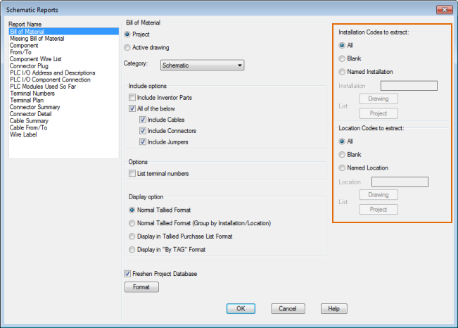

A standard set of schematic and panel reports are provided. Schematic reports extract intelligence from schematic components only. Panel reports extract intelligence from the panel components, except for the panel bill of materials which can include any schematic components not referenced on a panel layout.
You can use installation and location filters to control the information extracted. For example, if you assign a Location code of CUSTOMER to all of the customer-supplied components, you can then filter any report using the Location code. Use the Named Location and Named Installation sections of the report dialog box to filter the report by specific values.
Use a comma to separate multiple filter values. For example, you would enter CUSTOMER,FIELD to generate a report for components with either a Location value of CUSTOMER or FIELD.
You can also use the filters to exclude components based on the Installation or Location value. For example, to generate a report of all components except components with a Location value of CUSTOMER, enter ~CUSTOMER as the Named Location. The tilde (~) prefix causes the report to exclude those components with a Location code of CUSTOMER.
Use any of the following characters in the Installation and Location filters:
| Character | Definition |
# (pound) |
Matches any single numeric digit. |
@ (at) |
Matches any single alphabetic character. |
. (period) |
Matches any single non-alphanumeric character. |
* (asterisk) |
Matches any character sequence, including an empty one and it can be used anywhere in the search pattern: beginning, middle, or end. |
? (question mark) |
Matches any single character. |
~ (tilde) |
If it is the first character in the pattern, it matches anything except the pattern. |
, (comma) |
Separates two patterns. |
‘ (reverse quote) |
Escapes special characters (reads the next character literally). |

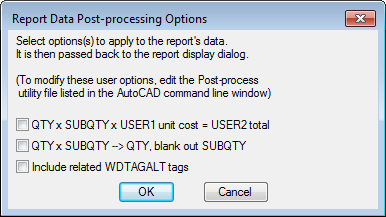

Each report type has an associated lisp file (.lsp) and dialog box definition file (.dcl) that can be customized to post-process the report data. When you run a report, the data is displayed in the Report Generator dialog box. If you click User Post, the dialog box defined in the associated .dcl file displays. The actual processing for each option on the dialog box is defined in the associated .lsp file.
Sample files are installed in the C:\Program Files\Autodesk\AutoCAD {version}\Acade\Support\{language code}\Shared\ folder. Add your own post-processing options to these sample files. Here are some examples that are in the BOM.LSP sample file.
The data is passed back to the Report Generator dialog box where you can save the report as a file, insert it as a table, or print it.

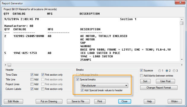

Once you generate a report, click Put on Drawing in the Report Generator dialog box to insert it as a table. Use the options on the Table Generation Setup dialog box to:
You also select from the following options:
You may want to break a report into multiple tables. These multiple table objects are considered one report table and are updated the next time you run the same report. Sections are added or removed as needed.
There are two ways to break a report into multiple tables:
If an entry in the report contains multiple lines of text, such as a Bill of Materials description, each line of text is considered a row. A table is not broken in the middle of a multi-row entry. The entire entry is moved to the next section.
After you select Special Breaks, and click Put on Drawing, the Apply Special Breaks option is available in the Table Generation Setup dialog box. This option inserts a table object for each section based on the Special Breaks.
If the scope of the report is set to Project, you can break a report table across multiple drawings. Once you have defined a break as described, you can define how many table sections you want on each drawing.
If the Sections On Drawing is blank, all tables for the report are inserted on the same drawing. If you enter a number for the Sections On Drawing value, you are prompted for another drawing each time that number of table sections is reached. You can insert the tables in existing drawings or new drawings. New drawings are added to the active project.

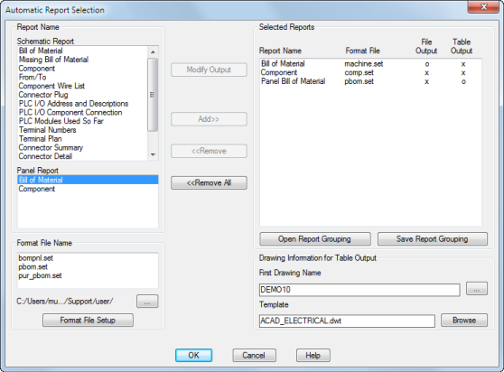

You can run one report at a time, or use Automatic Reports to run a group of reports. When you run a group of reports you can save each report to a file, place each report as a table, or both. Find
Select the report name and a format file (.set) for each report you want to run. The format files should define either file output, table output, or both.
You can save the report grouping so you can run this group of reports at any time.
