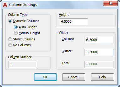

The following options are displayed.
Displays choices for the type of columns you want to create.
Sets the number of columns. This is only active when you select Static Columns.
Displays text height when Auto Height with Dynamic or Static Columns is selected.
Displays and specifies control column and gutter width values. The gutter value is five times the default text text height.
Also displays the total width value of the text object.
