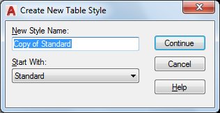

Specifies a name for the new table style and specifies the existing table style on which the new table style will be based.
The following options are displayed.
Names the new table style.
Specifies an existing table style whose settings are the default for the new table style.
Displays the New Table Style dialog box, in which you define the new table style.
