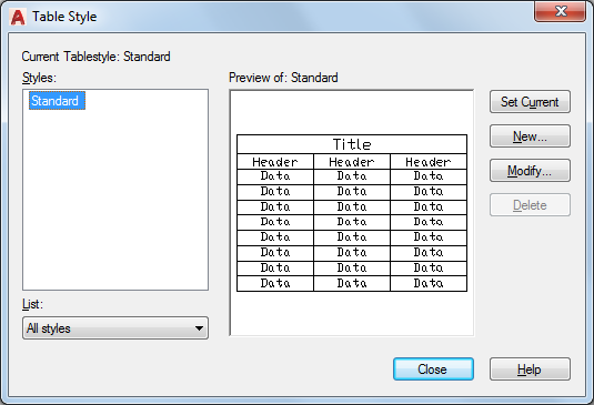

The following options are displayed.
Displays the name of the table style that is applied to tables you create.
Displays a list of table styles. The current style is highlighted.
Controls the contents of the Styles list.
Displays a preview image of the style that is selected in the Styles list.
Sets the table style selected in the Styles list as the current style. All new tables are created using this table style.
Displays the Create New Table Style dialog box, in which you can define new table styles.
Displays the Modify Table Style dialog box, in which you can modify table styles.
Deletes the table style selected in the Styles list. A style that is being used in the drawing cannot be deleted.
