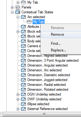

Remove a Ribbon Tab from a Contextual Tab State

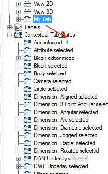

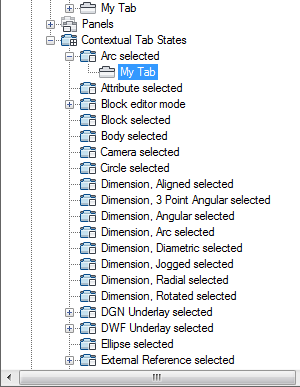

Assign a Ribbon Tab to a Contextual Tab State
- In the Customize tab, Customizations In <file name> pane, click the plus sign (+) next to the Ribbon node to expand it.
- Click the plus sign (+) next to the Tabs node to expand it.
- Click the plus sign (+) next to the Contextual Tab States node to expand it.
- Drag a ribbon tab from the Tabs node to a ribbon contextual tab state.
- Click Apply.
- Click the plus sign (+) next to the contextual tab state that contains the ribbon tab you want to remove.
- Right-click the ribbon tab under the contextual tab state and click Remove.
- Click Apply.
