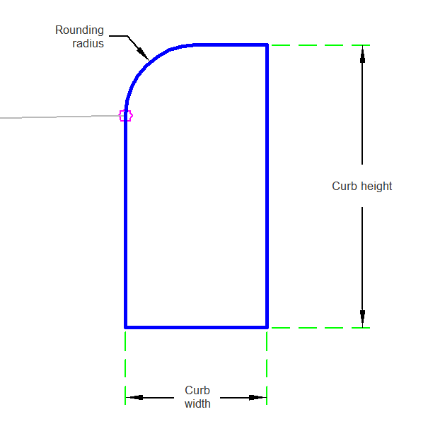

CurbWallRadius
The CurbWallRadius subassembly is used as a standard 6" (0.15 m) / 12" (0.30 m) curb wall with user defined input for multiple widths and for the curb radius.
The attachment point is at the start of the curb wall radius point.

Specifies which side to place the subassembly. Left/Right
Right
Curb Width
Width of curb. Numeric, positive
0.5 ft
0.15 m
Curb Height
Height of curb. Numeric, positive
1 ft
0.30 m
Rounding Radius
Radius for the rounding at the front of the curb. Numeric, positive
0.5 ft
0.15 m

The curb links are inserted based on the Input Parameter dimensions. All dimensions must be positive, non-zero values to get the best results. The parameters are checked to ensure if the input radius will give a valid result.
In order to provide a solution mathematically possible, the subassembly will compare the radius to both the width and height entered. If the width or height is smaller than the radius then one-half of the smaller value of width or height will be used.
The subassembly builds the shape for a simple curb with radius, with the attachment point at the bottom radius of the curb.

P1 Attachment Curb attachment point
P2 Face_Curb, Datum Face of curb
P3 Datum
P4 Back_Curb Back of curb
P5 Top
L1 Curb, Datum Curb below attachment point
L2 Datum
L3 CurbBack Back of curb
L4 - L5 Top
S1 Curb
Coding Diagram
