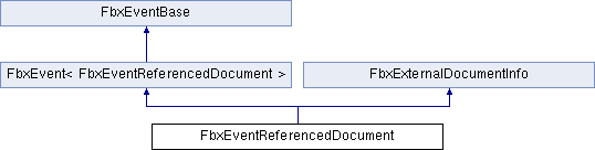

 Inheritance diagram for FbxEventReferencedDocument:Public Member Functions | |
