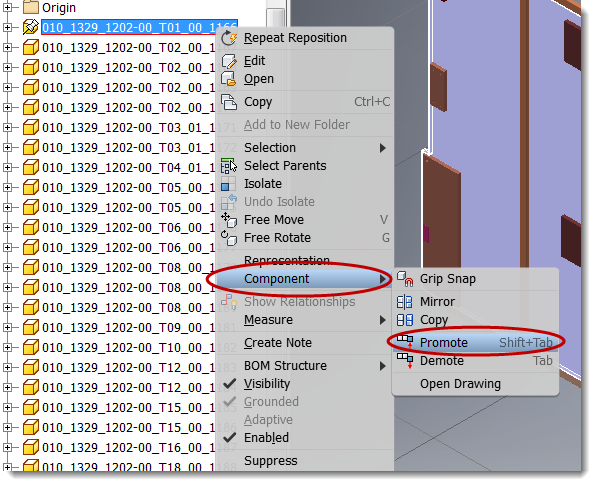

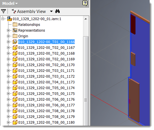

  1. Click + next to the imported assembly in the Model browser.
  2. Locate an item to convert to an asset. Right-click, select Component, and then select Promote.
    The message "The restructure operation may result in lost features..." appears. Select Yes to continue.
    Note: You can also drag and drop items in the browser to rearrange and group models together.

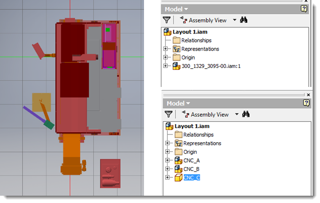

  3. Repeat step 2 until all items are structured as desired. In this example, the file is restructured to convert three items (CNC_A, CNC_B, CNC_C) to assets and to maintain their relationship.
  4. Click the Save icon at the top of the window or press Ctrl+S to save the file.

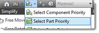

  1. Locate an assembly in the Model browser, right-click, and select Open.
  2. From the menu bar, change the selection priority to Select Part Priority.
  3. In the model, locate an item for which you want to turn off visibility.

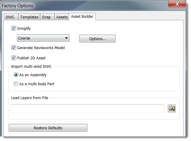

Setting Convert Options
The Convert to Asset command uses a shrinkwrap feature to simplify files. Properly configuring the simplification options is critical for successfully creating lightweight models. You can configure simplification settings from the Asset Builder tab in Factory Options.
Medium and Coarse options automatically appear in the drop-down list. Custom options might also appear and are defined in the User App Data folder (%AppData% \Autodesk\Factory Design Suite 2017\Simplification\). Click options to enter additional simplification settings.
