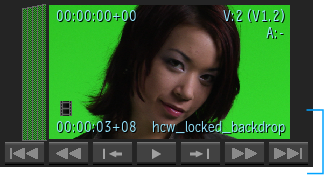

You can scrub a clip or sequence by using the transport section under the reel or by dragging left or right on the lower third of a frame.
When scrubbing a clip, the selected clip outline disappears, giving you a cleaner interface. All clip information is hidden, except for the Current Frame / Timecode / Keycode and the File Format icon. This also applies to clips in the Media Panel (Tiles), the Freeform view and the MediaHub (Tiles and Preview Panel).
Click: | To: |
Go to the previous clip or sequence on the reel. |
Go to the first frame of the clip or sequence currently over the reel's playback controls. |
Scrub the reel backward. |
Load the clip currently above the playback controls into the Player for full-resolution playback. |
Scrub the reel forward. |
Go to the last frame of the clip or sequence currently over the reel's playback controls. |
Go to the next clip or sequence on the reel. |
To scrub a reel using the cursor:
The cursor displays two white arrows on each side.
