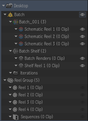

There are three types of Desktop reels available to help organize media:
- Schematic reels containing sources used in Batch process trees. Located under a parent Batch group.
Additional schematic reels may be created if needed by right-clicking the Batch group or reel and selecting New Schematic Reel.
- Shelf reels, where media can be organized and accessed in Batch without cluttering up schematics and their process trees. The Batch Renders reel is a shelf reel provided as the default destination for all clips rendered via the Render node; however further shelves may be added or deleted as desired.
Additional shelf reels may be created if needed by right-clicking the reel and selecting New Shelf Reel.
- Reel Group reels, where media can be organized outside of Batch but still on the Desktop. A Reel Group and the Sequences reel are central to the
Connected Conform workflow.

Viewing Reels
The contents of reels are best displayed using Desktop Reels view in the Viewing panel. To enable Desktop Reels view, do one of the following:
In the Media panel, click the eye icon beside each reel to toggle its visibility.
If the number of visible reels exceeds the maximum displayable in the Viewing panel, additional reels are hidden automatically. In the Media panel, the eye icon will turn black to show that visibility has been turned off by the system. Clicking a hidden reel when there is no space to display it will also turn the eye icon black. To view automatically hidden reels, first turn off the visibility of a corresponding number of reels in the Viewing panel.
Note: The maximum number of reels that can be displayed in the Viewing panel depends upon screen size and resolution.
