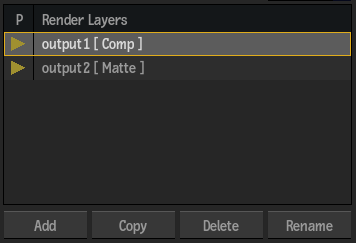

Render Layers List
Lists all of the existing render layers. Use the buttons below to populate the list with the render layers you want. To deselect an render layer from rendering (but keep it in the list), click the yellow arrow beside the output.
Add button
Adds a new render layer to the list. Use the Rename button to change the name to something more meaningful.
Tip: Use the Output Naming settings in the Action Setup Preferences menu to set default naming conventions for your outputs.
Copy button
Creates a copy of a selected render layer.
Delete button
Deletes the selected output from the list.
Rename button
Opens the onscreen keyboard to rename the selected render layer in the list. Renaming a Render Layer automatically renames all output sockets enabled from that Render Layer.
