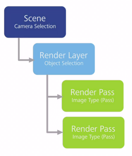

Action Output Workflow
When using the Action Output menu, you usually follow the options from left to right.
Step: Action:
1 Use the Render Layers list to add, copy, delete, and rename render layers.
2 Set Outputs Options: select the Primary output type, the camera to output, and any render passes per render layer.
3 Set Rendering and Ambient Occlusion Options, as necessary.
4 Select objects to output.
5 Render your outputs from Action (using the options in the Render button and dropdown list).
