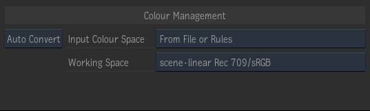

From the General tab of the MediaHub, you can manually apply a LUT or Colour Transform or automatically convert different media types to an appropriate working space on import.
All imported media is also tagged with a colour space identifier. See also: Tagging Clips with a Colour Space
Start by selecting the appropriate option from the Colour Management mode box. Available modes are:
The "From File or Rules" option will attempt to automatically deduce the colour space of the source by looking at the file header and using the colour management Input Rules.
For ARRIRAW, RED, and SonyRAW formats, using Auto Convert with the "From File or Rules" option converts directly to the chosen Working colour space using the highest quality path (i.e. you do not have to worry about which camera-specific Gamma and Colour primaries to specify in each format's SDK options). Auto mode is also supported in MediaReactor, so you can add Rules for file types that are imported in that way.
The Auto Convert mode is equivalent to the Input Transform mode in the Colour Management Timeline effect and Batch node.

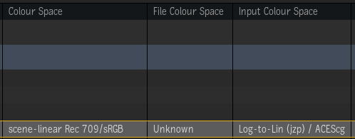

The Media List view optionally shows various colour space metadata relevant to import. (Columns may be enabled by right clicking in the table header.)
The interpretation of the columns is as follows:
The Input Colour Space and Colour Space are also shown in the MediaHub Preview panel Clip Info.
