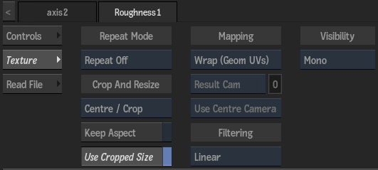

Texture Tab
Repeat Mode box
Select how the map pattern is repeated on the surface.
Fit Method box
Select a fit method option to be applied to the PBS map.
Keep Aspect button
Enable to preserve the aspect ratio of non-square pixels (not available for the Fill fit method).
Use Cropped Size button
Enable to replace the PBS map with the cropped size of the PBS media. Disable to use the cropped PBS media as is.
Mapping box
Select the type of texture mapping.
Wrap (Geom UVs) Wrap mapping completely envelops the 3D model with the PBS map according to the object’s coordinates. To use this option, you must import a model that has its own texture coordinates. When using Wrap mode, you can also apply UV mapping settings from the Geometry menu. See http://beehive.autodesk.com/community/service/rest/cloudhelp/resource/cloudhelpchannel/guidcrossbook/jsonp?v=2017&p=FLAME&l=ENU&guid=GUID-641D3BA4-E9EA-453C-B196-147EDC6B0BFA.
Plane Planar mapping applies the map without distorting the front plane of the 3D model, similar to a movie projector casting an image onto a screen. All 3D coordinates of the geometry are mapped to this plane to generate the texture values. Planar mapping positions the lower-left corner of the diffuse map on the 3D model’s axis. When you apply planar mapping, any surfaces on the 3D model perpendicular to the front plane cause the pixels at the edge of the texture to project along the “sides” of the object.
Perspective Perspective mapping is similar to planar mapping, except that it performs a perspective transformation of the texture map based on the selected camera’s field of view (FOV). When you select Perspective as the mapping type, the Perspective Camera box becomes active, allowing you to specify the active camera. The FOV of the camera has an impact on the resulting effect of any transform applied to the parent axis of the texture. On stereo cameras, the interaxial distance between left and right cameras also has an effect on the resulting perspective transform.
Projection The texture behaves as if it is projected by the selected camera. Projection mapping is useful as an alternative to projecting textures using the Projector node, especially when it is necessary to project while preserving a specific camera POV.
Camera box
Specify which camera's FOV to take into account when using perspective or projection mapping.
Camera field
Displays the active perspective or projection camera number. Non-editable.
Stereo Camera Projection box
Select whether to use the centre, left, or right camera from a stereo camera rig when projection mapping.
Filter box
Select the type of filtering to apply to the PBS map.
Select: To apply:
Nearest No filtering — the pixel of the texture closest to the screen pixel is displayed.
Linear Basic bilinear filtering.
Anisotropic Non-proportional filtering between X and Y (faster to process than EWA, but with a lesser quality).
Aniso+Linear A combination of Anisotropic and Linear filtering.
EWA A high-quality elliptical weighted average filter to produce enhanced rendering results (slower to process than other filters).
EWA+Linear A combination of EWA and Linear filtering (offers the most advanced filter processing).
Tip: You can set the default filtering type in the Action Setup menu Preferences tab.
Camera Type box
Select the camera type visibility for the map. For example, you can use this setting to apply a Left Eye and Right Eye camera type for two maps that are children of the same surface or geometry in a stereo scene.
