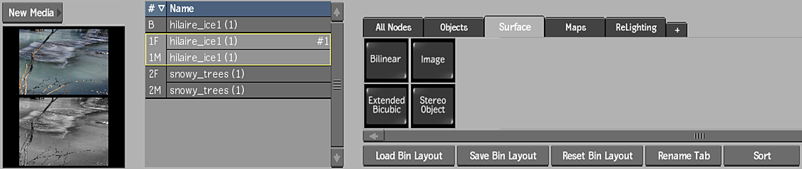

Using the Action Node Bin
The Action node bin contains nodes classified by tabs. The All Nodes tab contains all Action nodes. The other tabs in the node bin allow you to create and customize bins. The node bin also contains an image proxy that displays a proxy of the currently selected media, as well as a mini Media list.
To access the node bin, click the Action Bin button.
Some nodes are duplicated in other bins according to a preset tab classification. For example, the Light node is found in both the Objects and ReLighting tabs.
Nodes are listed in alphabetical order from top to bottom of each row. You can customize any of the bins and preset tabs except the All Nodes bin.

Customizing the Node Bin
Create custom tabs and populate them with your most commonly used nodes to optimize your workflow. As well, change the order of the tabs along the top of the bin and rename them to reflect the contents of a tab.
Note: The All Nodes, Lightbox, and Matchbox tabs cannot be customized or deleted.

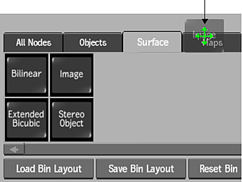

To reorder a node within a tab:
  1. Press Alt+Win and drag the node to a new location. You can move nodes from one row to another as well as reorganize nodes within a row.
  2. Release the cursor when it changes to a green crosshair at the location where you want the node moved.
    If you dragged the node on top of an existing node, the existing node shifts to the right and the moved node is inserted in its place.

To reorder a tab:
  1. Press Alt+Win and slide the tab to its new location.
  2. Release the cursor at the new location for the tab.
    If you dragged the tab on top of an existing tab, the existing tab shifts to the right and the moved tab is inserted in its place.
