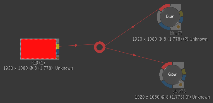

Instead of using the default straight line connections between nodes, you can add Elbow nodes to reshape the node connections. Elbow node connections can be useful to clean up the schematic view, and avoid links crossing each other.
There are many benefits to using Elbow nodes in your schematic:
Adding an Elbow Node to the Schematic
An Elbow node can be added to the Schematic in the following manners:
- By enabling the Add Points Edit mode and clicking on a link to add an Elbow node.
- By holding down the Add Points shortcut (A) to add elbow nodes and then letting go of the shortcut to return to the previously selected Edit mode.
- By clicking on a node output to insert an Elbow node between the output socket as well as all of its outgoing links.
