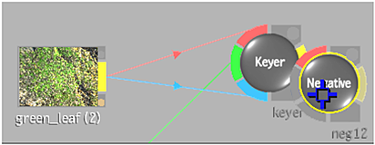

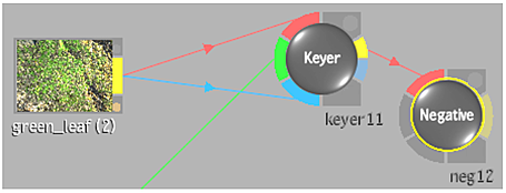

- Use the Autolink feature by pressing Shift and dragging a node to another node so their tabs touch.
Action: Press and hold Shift while dragging the Negative node to the Keyer node
Result: The Keyer output is the front for the Negative node

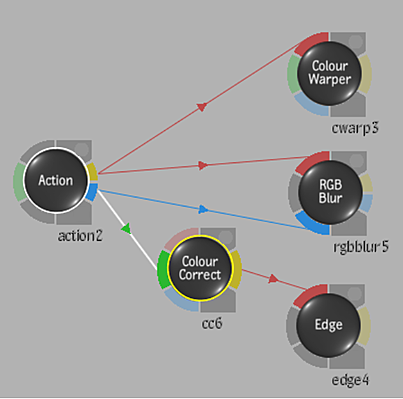

To connect nodes using the advanced autolink:
- To distinguish between the various source tabs, use the Advanced Autolink feature by pressing Alt repeatedly while still holding Shift to extend a similarly coloured arm from each source tab (starting with the topmost source tab, and cycling counter-clockwise with each press of Alt). The name of the tab is also displayed above the node. Touch the extended arm to the tab to be connected.
Approaching a node with multiple outputs, such as a multi-channel clip imported with a Read File node, automatically expands that node.
| Hold Shift and press Alt to extend the Front tab. |
| While still holding Shift, press Alt again to extend the Back tab. |
| While still holding Shift, press Alt a third time to extend the Matte tab. |
Any connections made using this method will be retained by releasing the node over an existing connection as it turns orange.

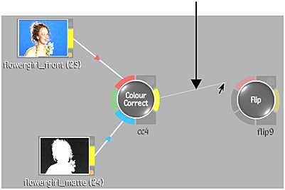

To connect nodes manually:
- Click the Result tab of a node whose result to be used and drag the cursor to one of the source tabs of the next node in the process tree.
An arrowed line is drawn from the node to the source tab. For example, click the Result tab of the Colour Correct node and drag the cursor to the front tab of the Flip node to flip the result of the colour-corrected clip.
