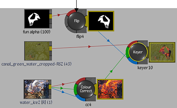

To bypass a node input:
The Bypass box becomes active.

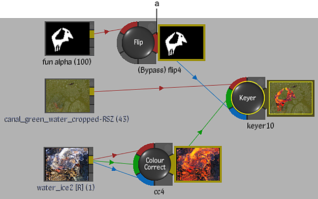

The output tab of the bypass node changes colour. In the following example, the tab turns red indicating that the Front input is passed to the next node in the tree. As well “(Bypass)” is added to the node name.
(a) Output tab of bypassed Front input
