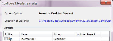

A new Content Center library for IDF components installs with the 2016 R2 (Subscription only) release.
You can now build an IDF component library in Inventor:
  • Author and publish parts with the new Manage Author IDF Component command to the new IDF Component Content Center Library.
  • When you import/open an IDF file, all library components in the IDF Component Content Center Library are automatically reused in the import.

  • By default, all library components in the IDF Component Content Center Library will be reused when you import/open an IDF file. To create new parts for IDF components deselect the new Reuse Components in Content Center checkbox.
