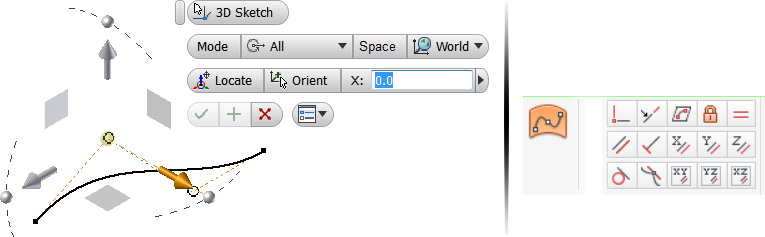

Sketch
New 3D sketch commands provide greater control, speed, and ease of use.
  • A new 3D Transform command provides a rich set of geometry manipulation tools for moving and rotating geometry quickly and precisely.
  • New constraint types are added to provide greater control and allow you to sketch curves on 3D faces.
  • Copy/Paste supports copying and pasting in the same 3D sketch or between 3D sketches, reusing 3D sketch information for faster model creation.
What's New Video: 3D Sketching
For more information, see 3D Sketch Enhancements.

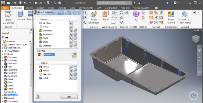

A new Feature Relationships tool identifies parent and child relationships between part features. This helps you quickly understand how parameters define the model, and can be used to execute or automate geometry changes.

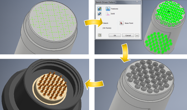

  • The Sketch Driven Pattern command quickly generates features or bodies in complex arrangements defined in a 2D or 3D sketch.

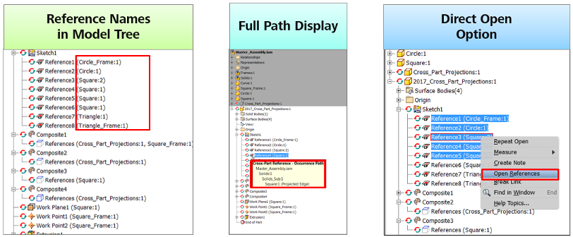

Enhanced reporting of cross-part references within assemblies helps you more easily identify and access related parts.

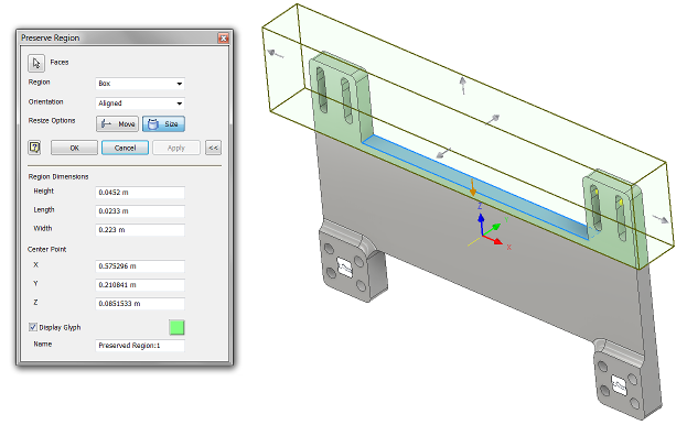

Shape Generator (not available in Inventor LT)
Shape Generator, introduced in Inventor 2016 R2, helps with the conceptual design of structurally efficient parts. For Inventor 2017, several enhancements were made to the Shape Generator workflow and new controls were added.
Glyphs provide feedback on the location of Fixed, Pinned, and Frictionless constraints. These glyphs also now appear in the Stress and Modal Analysis environments in Inventor Professional.
  • Interactive controls are provided for preserved region sizing and positioning
  • New minimum member size criteria influences the size of features in Shape Generator outputs
  • Users may directly assign the target mass rather than use a percentage reduction
  • A new optional symmetry constraint causes outputs to be symmetrical about one or more planes
Preserve Region
Minimum Member Size
Symmetry
What's New Video: Improved Shape Generator
For more information, see About Shape Generator.

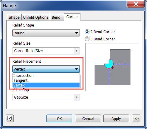

Sheet Metal
New workflow options and controls were added to the sheet metal environment in Inventor 2017:
  • Expanded defer options
  • Improved flat pattern warnings
  • Ability to individually control punch reps
  • New corner relief options
For more information, see http://beehive.autodesk.com/community/service/rest/cloudhelp/resource/cloudhelpchannel/guidcrossbook/jsonp?v=2017&p=INVLT&l=ENU&guid=GUID-354E5102-3B95-4E0B-ACF9-DE6747466C07.

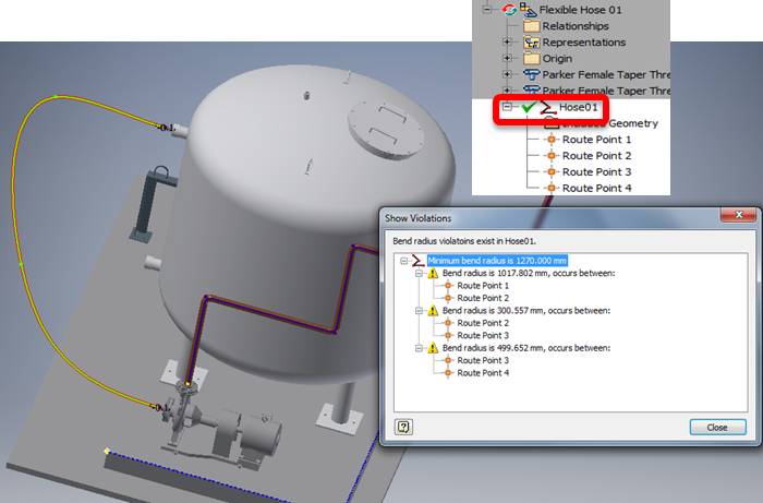

Tube & Pipe (not available in Inventor LT)
Several efficiency enhancements were made in the Tube and Pipe commands including:
  • Find in Browser command is enabled within routes.
  • There is support for Multiple Intermediate Point Creation on flexible hoses with fittings.
  • A new Show Violations dialog box provides visual feedback for flexible hose violations.
  • The Tube and Pipe Authoring and Tube and Pipe Styles dialog boxes are resizable.
  • The destination folder in the Location for Run File field automatically updates when you change the name in the Tube and Pipe Run Name field and Run File Name field.
What's New Video: Tube and Pipe Design
For more information, see Tube and Pipe Enhancements.

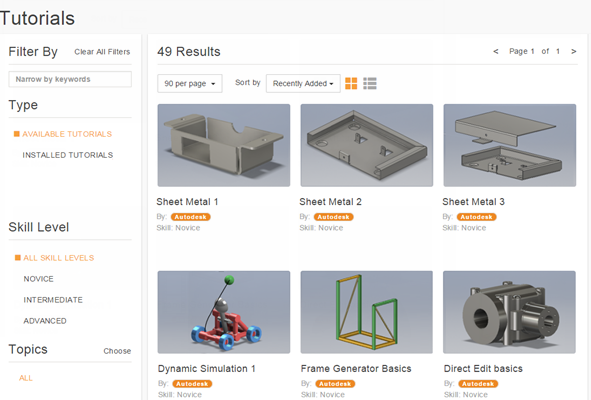

Guided Tutorials (not available in Inventor LT)
The Guided Tutorials have been enhanced for greater visibility and usability. The Videos and Tutorials pane is removed. Click Tutorials in My Home to view the new gallery. The gallery contains a live display of all tutorials currently available for download, and all installed tutorials. In addition, progress tracking is displayed in the gallery image and the active tutorial.
For more information, see General Enhancements.

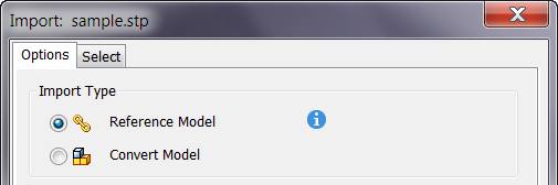

Inventor 2016 introduced a method of associatively linking nonnative geometry to your Inventor model using a technology called AnyCAD. In Inventor 2017, significant enhancements were made to the Reference Model update behavior for CATIA, Solidworks, NX, and Pro-E/Creo files. Increased support for multithreading in import workflows results in increased performance and faster updates for reference model workflows. As well, Reference Model also supports STEP neutral file format. A STEP model can be referenced into an Inventor assembly. When the STEP file is updated, Inventor accounts for the design change in a manner similar to other 3D formats.

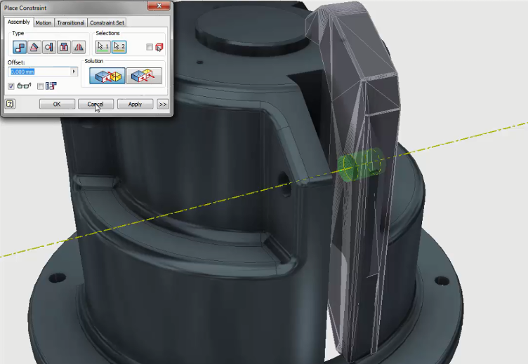

Mesh Handling
Mesh data can be brought into Inventor and managed, in the same way as other 3D CAD data. Measure and section tools can be used on mesh faces. Mesh can be selected and projected into sketches. The Fit Mesh Face command optionally allows users to convert a mesh face to a native Inventor surface, enabling the geometry to be edited downstream.
What's New Video: Improved Mesh Handling
For more information, see Mesh Component Enhancements.

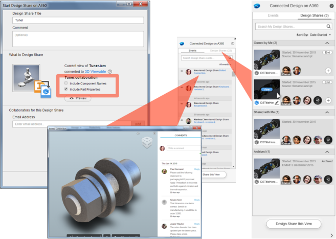

A Design Share capability was added in Inventor 2016 R3 to facilitate design reviews with your team and other project collaborators anywhere, on any device. Several enhancements in Inventor 2017 make it faster and easier to collaborate. Collaborators and feedback can now be reviewed and managed directly inside Inventor. New controls permit you to share part properties and part names in addition to the model graphics for more detailed reviews.

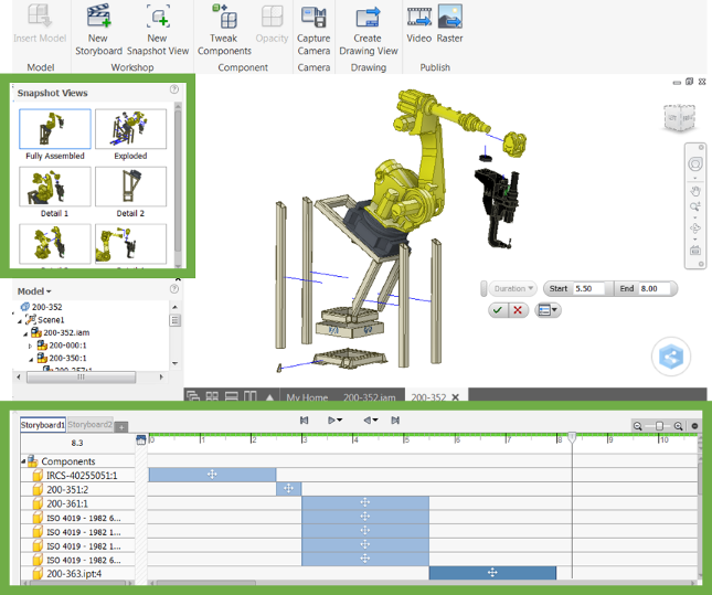

Presentation Enhancements (not available in Inventor LT)
The presentations environment is enhanced to make your documentation creation tasks easier and faster.
  • You can easily arrange components in exploded views for drawing creation and quickly create powerful and expressive animations.
  • Snapshot views allow you to capture specific model and camera arrangements for use in drawing views and raster image outputs.
  • A new timeline-based story panel makes it easy to control and edit assembly sequences or movement. You can change the duration or order of actions appearing in an animation.
What's New Video: Amazing Presentations
For more information, see Presentations, Exploded Views, and Publishing Enhancements.
