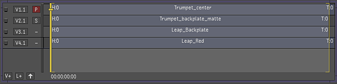

Here is a matte container with 3 matte tracks, V2.1 is set as the secondary.
