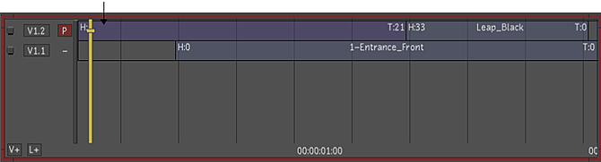

Matte containers on the timeline are purple:
