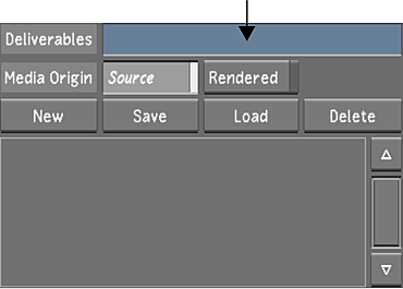

To create a real-time deliverables setup:
The Grade menu appears.
The button automatically switches you to Real-Time Deliverables view mode, and enables GPU processing See GPU Acceleration.
The setup is saved to the scene's Library folder as an XML file. The file uses the real-time deliverables setup name, preceded by the name of the grade on which it is based. For example, if the grade name is grd01, and the setup name is My_HD, the XML grade file is [grd01]My_HD.deliv.xml.
Once a setup exists, it can either be loaded to the grade for which it was created, or loaded to a different grade.
To load a setup to the grade for which it was created:
This loads both the grade and the setup.
To load a setup to a different grade:
This loads the setup to the grade.
To rename a setup:
To delete a setup:

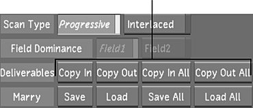

By default, unrendered changes to a grade file are not applied to real-time deliverables setups, and modifications made to a setup are not copied back to the grade. However, you can force changes to be copied back and forth either on a shot-by-shot basis or for the entire scene.
To share modifications between setups and grades:
| Click: | To transfer: |
| Copy In | Modifications made to the current shot from the grade to the setup. |
| Copy In All | Modifications made to the scene from the grade to the setup. |
| Copy Out | Modifications made to the current shot from the setup to the grade. |
| Copy Out All | Modifications made to the scene from the setup to the grade. |
