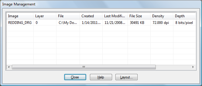

  3. Click Insert tabImage panelImage Management. Find
  4. In the Image Management dialog box, view information about the REDDING_DRG image.
    The Image Management dialog box displays information about the selected image.
  5. Click Close when you are finished.

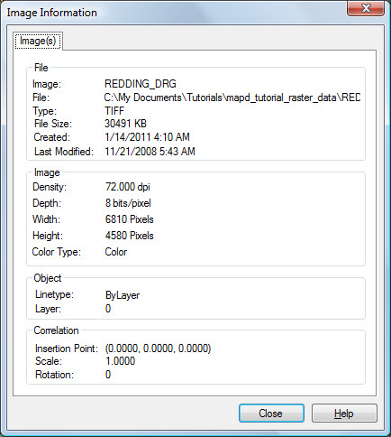

  7. Right-click the selected image and click ImageInformation.
  8. In the Image Information dialog box, view information about the REDDING_DRG image.
    The Image Information dialog box has some extra image information.
  9. Click Close when you are finished.
