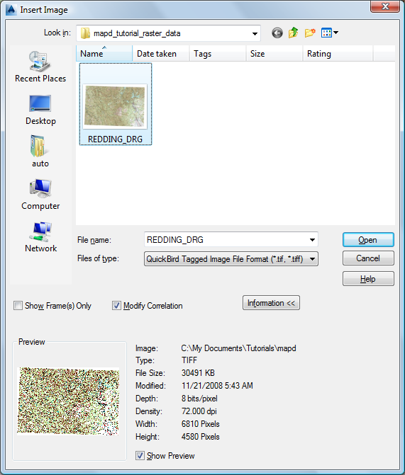

  3. Click Home tabData panelInsert An Image. Find
  4. In the Insert Image dialog box, do the following:
    • Navigate to the location where you stored your tutorial sample files.
    • In the Files Of Type box, select Tagged Image File Format (*.tif,*.tiff).
    • In the list of images, select REDDING_DRG.tif.
    • Click Information to display the file size, creation date, and other information, as well as a preview of the image.
      Information displays a preview and image statistics.
    • Select Modify Correlation.
    • Click Open.
