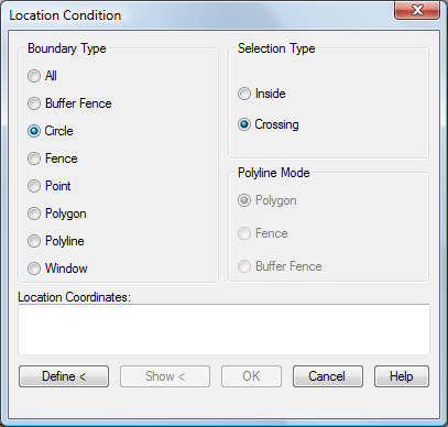

  3. In the Location Condition dialog box, do the following:
    • Under Boundary Type, select Circle.
    • Under Selection Type, make sure Crossing is selected.
      Objects that cross the circle you draw are added to the drawing.
    • Click Define.
