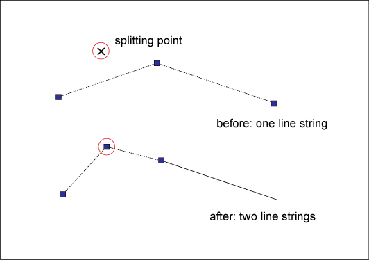

Line processing example: Split line creates two line features.
Icon
Description
Use Split to add a vertex and split an existing line into two line features. Both inherit the attribute data of the existing feature. You can select an existing point or digitize any point in the drawing.
