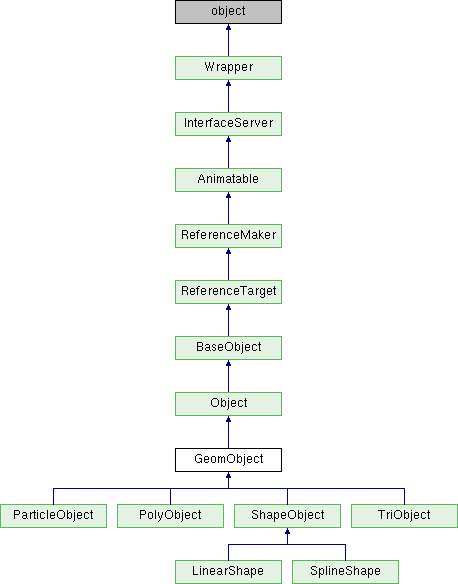

An object with geometry that can be rendered.
