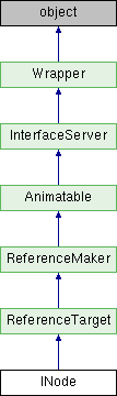

The interface to scene graph nodes. In addition to pointers to its a parent and children, a node contains references to the material and object and maintains information about its translation, rotation, and scale in 3D space.
Inheritance diagram for INode:Public Member Functions | |
