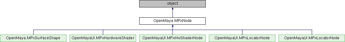

OpenMaya.MPxNode Class Reference
Base class for user defined dependency nodes.
