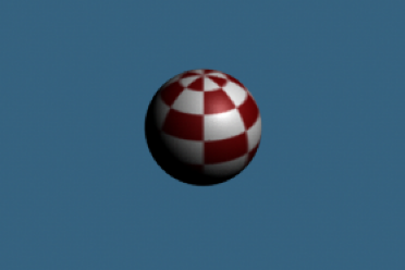

Color backgrounds
A color background floods the background of the rendered scene with a solid color (for example, black, white, or red).
To create a basic color background for the current camera
- Select
View > Camera Attribute Editor from the panel menus.
- In the
Attribute Editor, under the
Environment
section, set the
Background Color attribute.

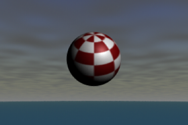

Texture backgrounds
A texture background uses a 2D, 3D, or environment texture on an image plane to simulate a 3D background, or
environment.
To create a texture background
- Select
- In the
Environment
section, click the
Create
button to the right of the
Image Plane attribute.
This creates an image plane and connects it to the camera.
- Set the
Type attribute for the image plane to
Texture.
- Click the texture icon
next to the
Texture
attribute.
- In the
Create Shading Node window that appears, select the texture you want to use as a background.
This connects the texture to the image plane.
