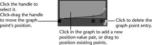

Graph
The graph control has handles which you can drag in the graph area to set position-value pairs. The active point has a white border around its handle and icon. Graphs can be used for many types of attributes where value changes per position, including paint effect settings, fluid settings, and so on.
