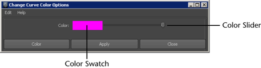

Changes the color of the curve selected in the graph view to the custom color specified in the Change Curve Color Options window.
Opens the Change Curve Color Options window. This window lets you create custom curve colors for the animation curves selected in the graph view.
You can also create custom curve colors for your animation curves from the Attribute Editor. See Change animation curve colors through the Attribute Editor.
Clicking on the Color Swatch launches the Maya Color Chooser. The Maya Color Chooser lets you select a new custom color for your curves.
Dragging the Color Slider increases or decreases the value of the color represented by the Color Swatch.
Applies the current swatch color to the animation curves selected in the graph view and closes the Change Curve Color Options window.
Applies the current swatch color to the animation curves selected in the graph view. The Change Curve Color Options window remains open.
Cancels the Change Curve Color operation and closes the Change Curve Color Options window.
Removes the custom curve colors from the animation curves selected in the graph view and returns them to their default colors.
Opens the Curve Colors window so you can set up a custom curve color scheme, associating curve colors with the names of the attributes. See Associate curve colors with attribute names.
