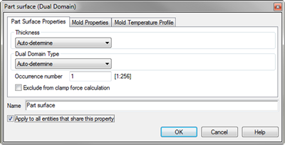

Once you have assigned a property to each of the entities of your model, you can edit those properties, if you find they are not set appropriately. For example, you can change the size or diameter of your cooling channels.
  1. Select the entities whose properties you want to change.
  2. Click (Geometry tab > Properties panel > Edit).
  3. Decide whether to Apply to all entities that share this property. If this option is checked, the changes you make will be applied to all elements on the model with the same property.
  4. Make the necessary changes to the properties in the dialog box, then click OK.
