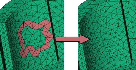

You can identify a hole to be filled, based on either the nodes, or the triangles, around the hole. Use the appropriate tool listed below, based on your preference.
To improve detection of the bend angle and to improve the quality of the patch, use the Ctrl key to select a second, or even third row, of elements directly connected to the first row surrounding the hole. This additional information is especially useful for curved surfaces.
Example
