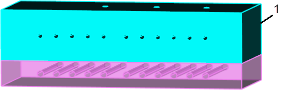

The fixed cavity is the mold cavity that does not rotate during the overmolding process.
  1. Using the Layers pane, Hide all other layers than the one containing the Fixed cavity mold (1).
  2. Click in the Model pane and press control + A to select it.
  3. Right-click in the Model pane and select Properties. Select Mold block (3D) and click OK.
  4. Select the Overmolding Mold Component tab, set the Component option to Stationary Component, then click OK.
The fixed cavity(1) does not rotate during the overmolding process.
