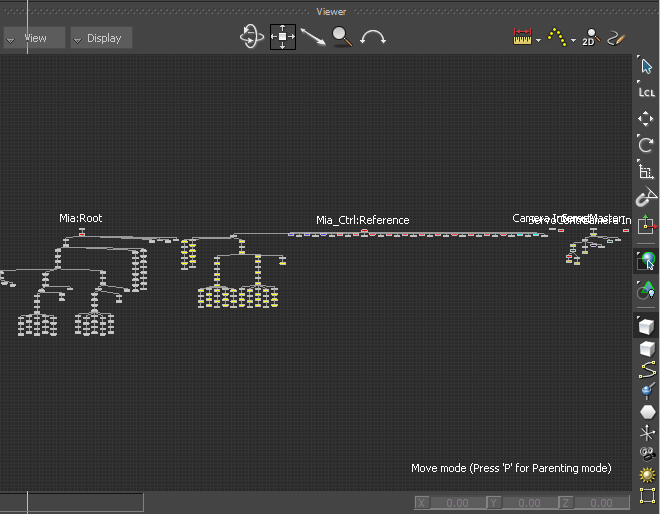

- In the Character Controls window, ensure Mia is selected as the current character.
- In the Viewer window, change View to Schematic view.
- In the Viewer window, click the View menu.
View menu options
- Choose Schematic.
Tip: To change View to Schematic, click the Viewer window and press Ctrl-W.
The Schematic view does not show all the nodes.
- In the Schematic view, right-click to access the Schematic view context menu.
- Enable Auto Arrange and click Arrange All.
- Press A to see all the nodes.
Mia’s skeleton node hierarchy (Mia:Root) is displayed on the left, Mia’s Control rig node hierarchy (Mia_Ctrl:Reference) is displayed in the centre, and the Servo arm (ServoMaster) node hierarchy is displayed on the right( in the Schematic view).

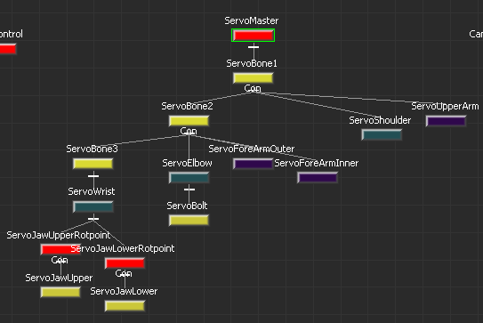

- In the Viewer window, pan (
or Shift-drag) and zoom in (
or Ctrl-drag) on the ServoMaster (Servo arm) node hierarchy to the right.
- Click the ServoMaster node.
The contour of the selected node is highlighted in green.

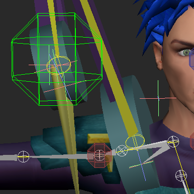

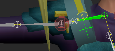

or Ctrl-drag) on Mia's right shoulder. The Servo arm null is highlighted in green, indicating it is selected.
- In the Viewer window Toolbar, right-click the Selection mode tool (
) and choose Parent from the context menu. Note: To switch to Parenting mode, you can also use the P keyboard shortcut.

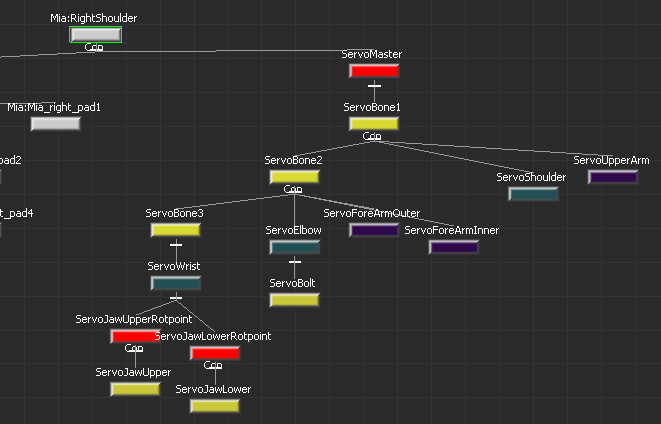

- With the Servo Master null still selected, click the Mia:RightShoulder bone.
The bone is highlighted in green as you parent the Servo arm.
The Servo arm is shown parented to Mia's right shoulder.
- Switch view back to Schematic (Ctrl-W).
Notice the ServoMaster node is parented to the Mia:RightShoulder node.

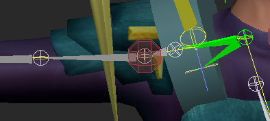

- In the Viewer window, select the Servo Control effector and then ensure you are still in Parenting mode (
- Parent the Servo Control effector to Mia’s right shoulder bone.

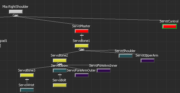

- Switch back to Schematic view to verify the ServoControl node is parented to the Mia:RightShoulder node as shown in the following figure.
ServoControl effector node and ServoMaster node parented to Mia:RightShoulder node
